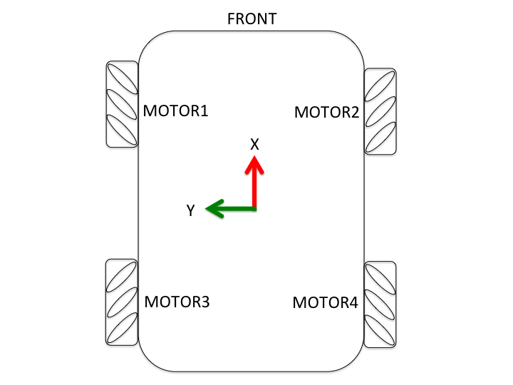

- ** Robot chassis layout **
- ** Main control ** : esp32 (ESP-WROOM-32)+** Rising Sun x3 Pie **(2GB)
- ** LiDAR ** : LD14
- IMU : MPU9250
- ** Motor ** : WGA12-N20 DC motor (12V, 1:50 reduction ratio)
- ** Motor drive chip ** : 4 RZ7889
- ** Encoder ** : AB dual phase incremental magnetic Hall encoder
- ** Power Supply: 12V lithium battery; -12V drive motor; External 12V to 5V module provides DC-5V output (maximum current 4A);
- ** Wheels ** : 4 wheat wheels, diameter 48mm
- ** Structural parts ** : Cut acrylic sheet, 3D printing

2.4 lib/kinematics
c++ package for solving the car chassis forward and inverse kinematics library. Suitable for two-round difference, Ackermann, wheat wheel, etc. The library of the original address: [kinematics] (https://github.com/linorobot/linorobot2_hardware/tree/galactic/firmware/lib/kinematics) Car wheel base, wheel diameter, speed and other information are defined in ‘lib/config’;
- Core function 1: Calculate the wheel speed of the car from the linear speed and angular speed
```c++ rpm getRPM(float linear_x, float linear_y, float angular_z); `
- Core function 2: linear speed and angular speed are calculated from the wheel speed of the trolley
```c++ velocities getVelocities(int rpm1, int rpm2, int rpm3, int rpm4); `
