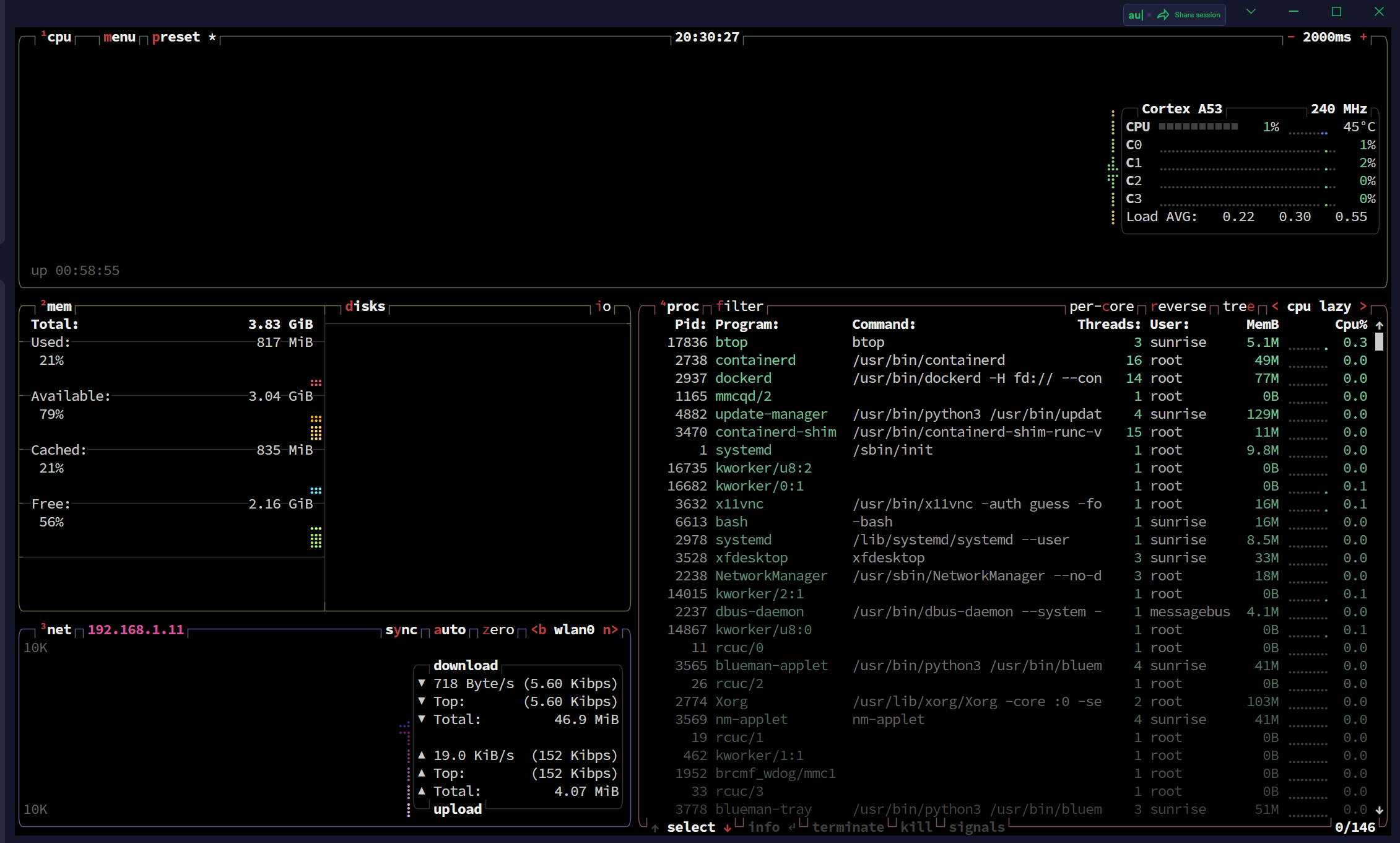

Let's run it
btop
![btopOnX3](https://developer.d-robotics.cc/en/staticFiles/prod/forumInfo/image/1717427093006.png)
You can see that our system and process information has been correctly identified
