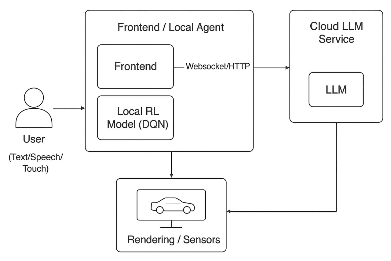

3.1 System Architecture
Specifically, the system architecture can be divided into:
  1. Cloud LLM Service: Responsible for dialogue understanding, generation, strategy prompt statements, game rule explanations, non-real-time strategy recommendations, etc.
  2. Local Agent (RDK X5): Receives cloud commands and local user input, runs DQN inference to control the MountainCar environment, and postbacks the environment state/reward to the front end and cloud (for display and logging).
  3. Communication: Uses lightweight protocols (such as WebSocket/HTTP REST), and messages include conversation context, game state, control commands, model logs, etc.
