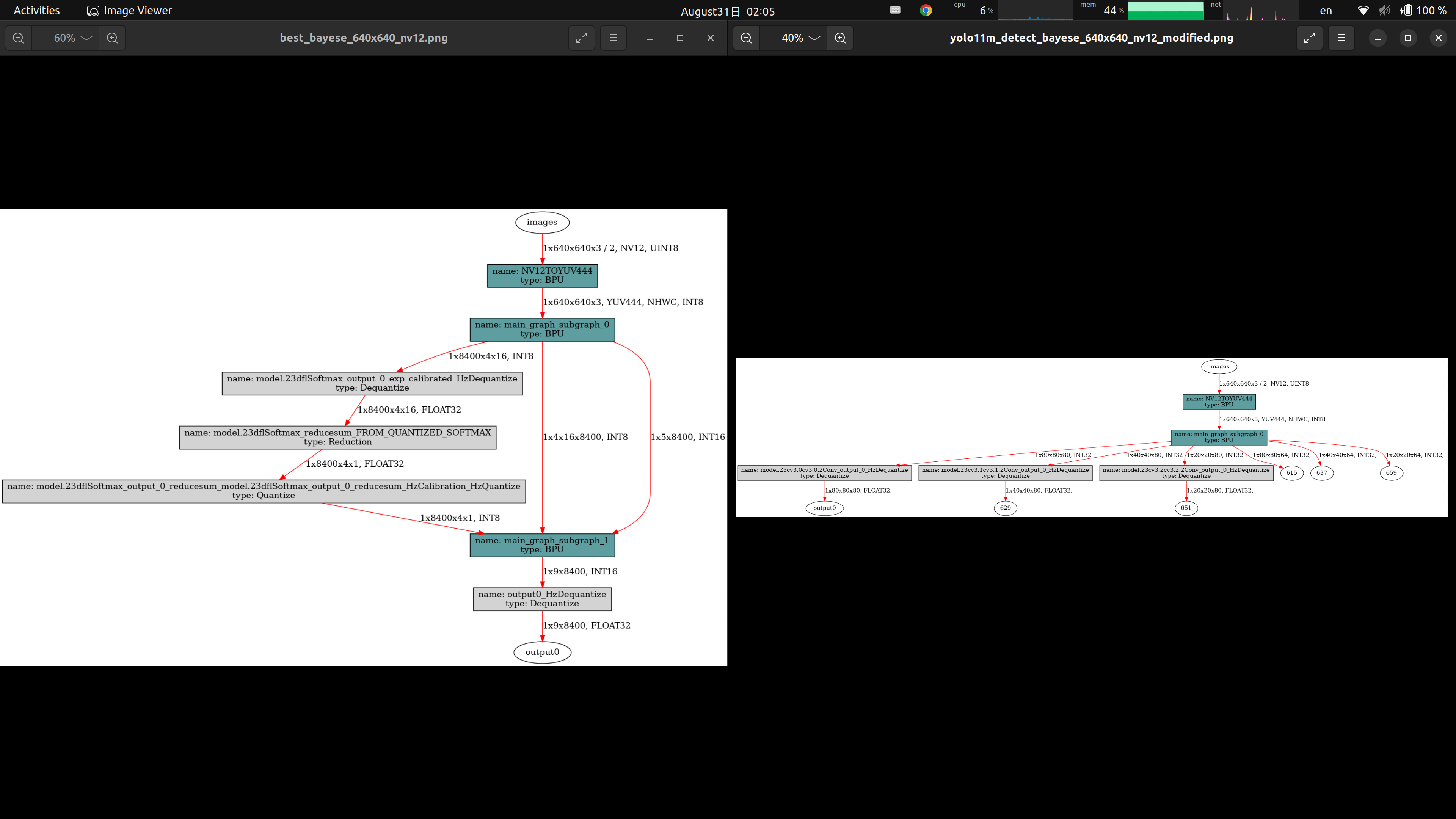

On the right is an algorithm for the BIN file downloaded from the model zoo, and the left diagram shows the model after converting my trained model into a BIN format.

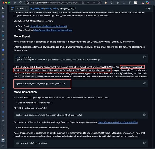

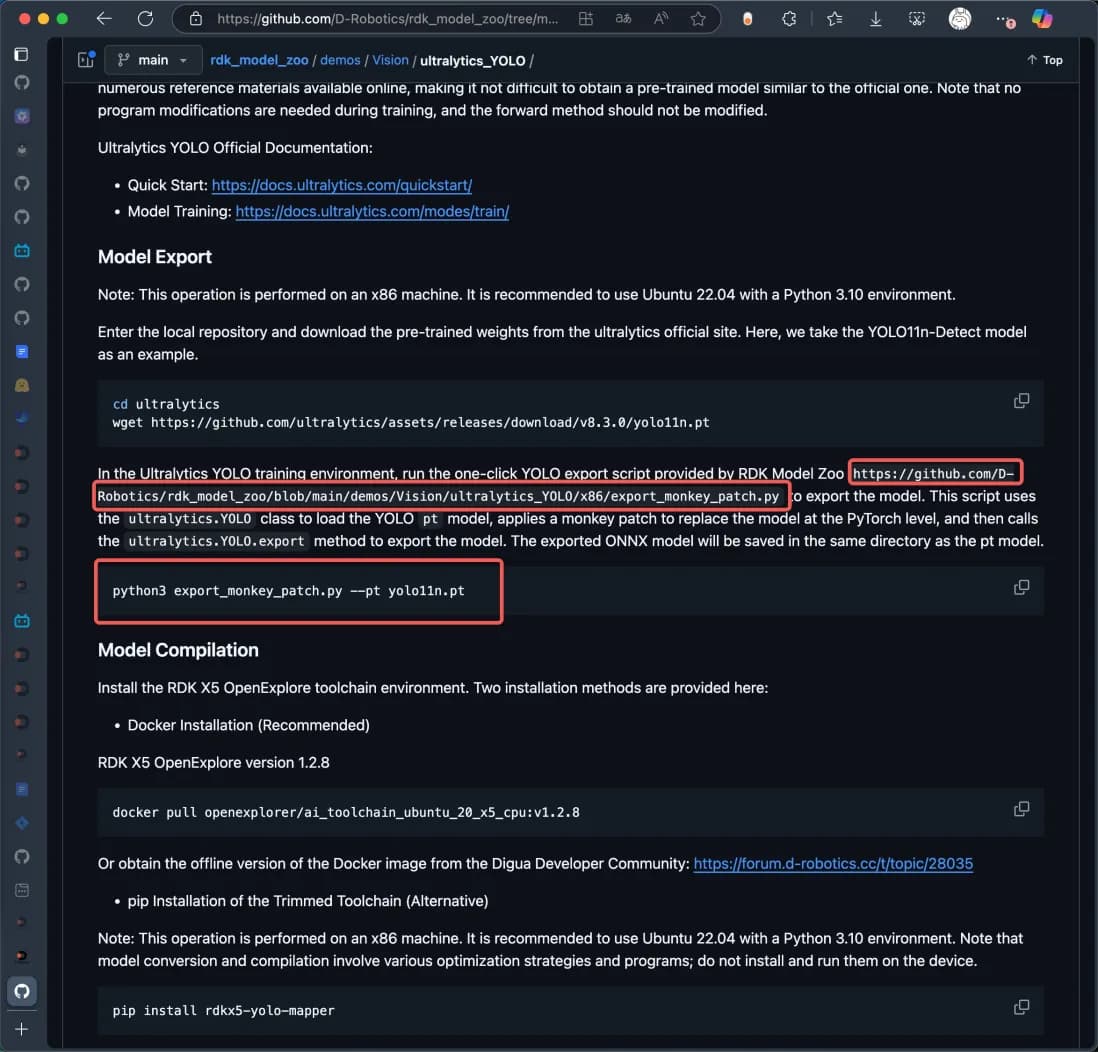

It turns out that after training the YOLO model, at the time you convert the model into ONNX, you have to use export_monkey_patch.py to revise the detector head to make it BPU adaptable.
Please take a look at this link: rdk_model_zoo/demos/Vision/ultralytics_YOLO at main ยท D-Robotics/rdk_model_zoo ยท GitHub
Let me know after you try that.

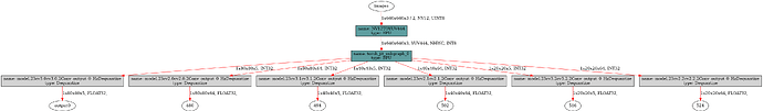

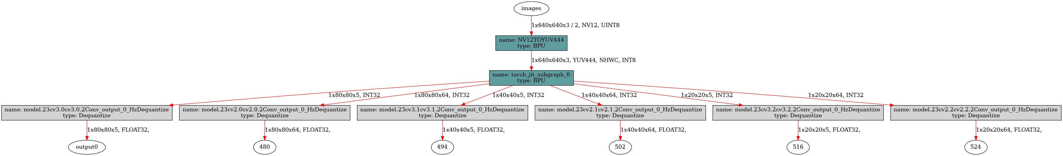

I followed your procedure as below and I converted onnx to bin file with only BPU process.
  1. I ran python3 export_monkey_patch.py --pt best.pt
  2. python3 rdk_model_zoo/demos/Vision/ultralytics_YOLO/x86/mapper.py --onnx best.onnx --cal-images Robomaster.v3i.yolov11/train/images/ this script modified to my converted weight,best.onnx.
  3. The following image is the output of hb_mapper checker --model-type onnx --model ./best.onnx
The graph is similar to downloaded weight of model zoo.
However, Iโ€™m not sure whether this is valid for image inference.
Could you share your opinion?
