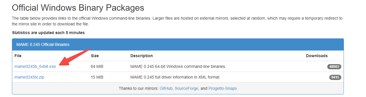

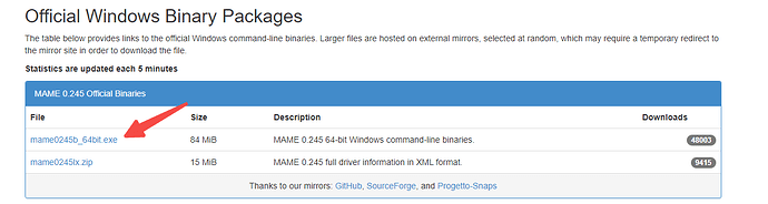

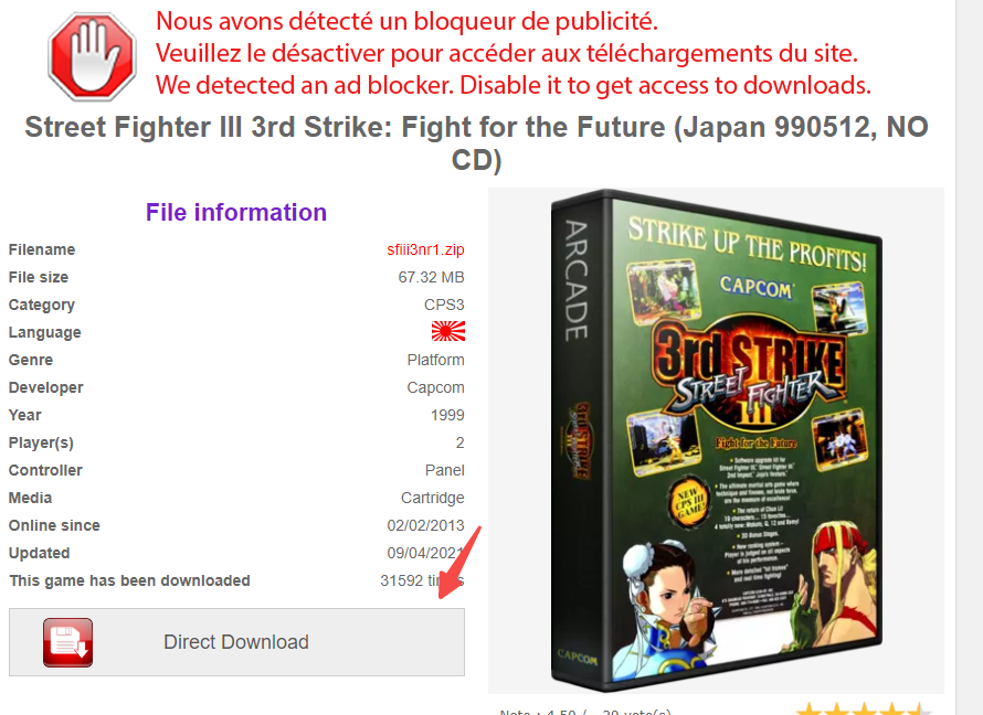

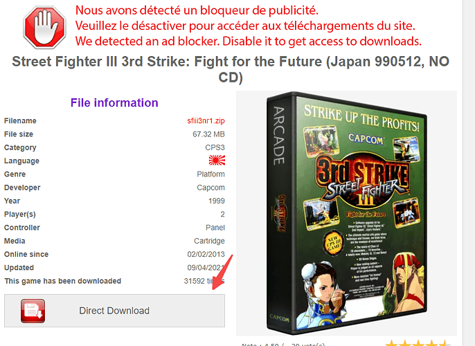

1.1 Install the Boxing Emperor game on the window computer
Because it is a key simulation, in theory, as long as it is a key controlled game can be played! I’ll use the mame emulator as an example)

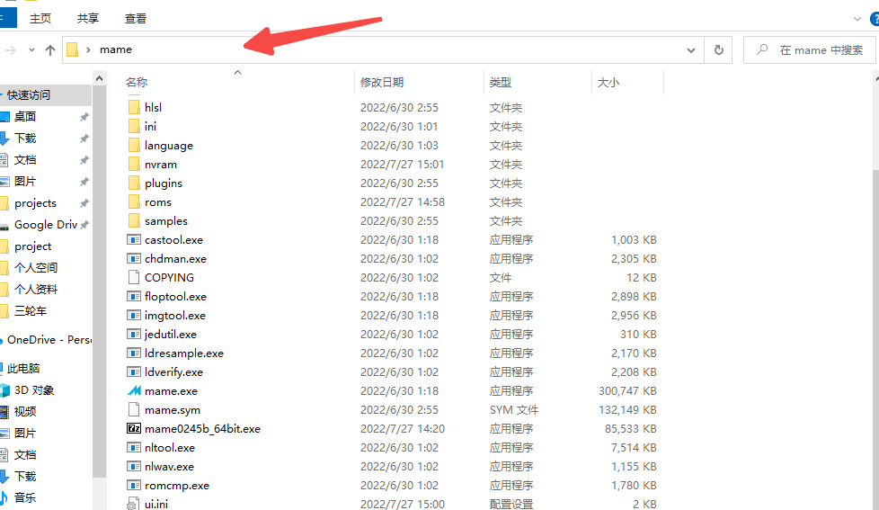

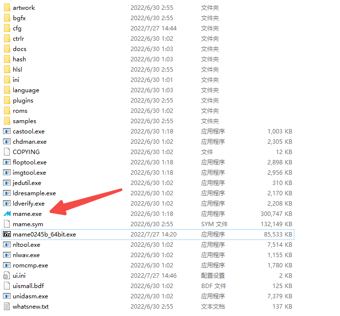

Download MAME:MAMEdev.org | Home of The MAME Project.

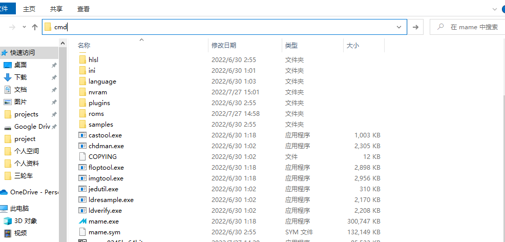

unzip
commands
mame -keyboardprovider win32 sfiii3nr1

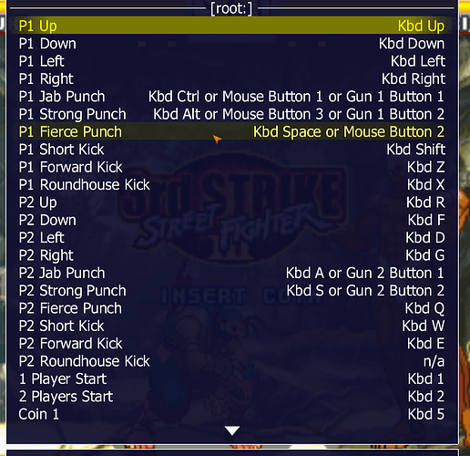

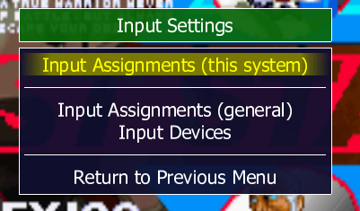

To view the information about the control button, press the key to display the setting screen. Select (double click or press enter) Input Settings, Input Assignments(this system), and you can find all the buttons. For example, kbd up is the up button on the keyboard. To modify a key, double-click or enter, and then type the new key.
One thing to note here is that the default keys of the game are partially different from the keys given in the code and need to be modified in advance. Modify keys according to the following mappings.
ACTION2KEY = {
    'COIN_P1': '5',
    'COIN_P2': '6',
    'P1_START': '1',
    'P2_START': '2',
    'P1_JPUNCH': 'L-CTRL',
    'P2_JPUNCH': 'A',
    'P1_RIGHT': 'RIGHT',
    'P2_RIGHT': 'G',
    'P1_LEFT': 'L',
    'P2_LEFT': 'D',
    'P1_DOWN': 'DOWN',
    'P2_DOWN': 'F',
    'P1_UP': 'UP',
    'P2_UP': 'R',
    'P1_SKICK': 'L-SHIFT',
    'P2_SKICK': 'W',

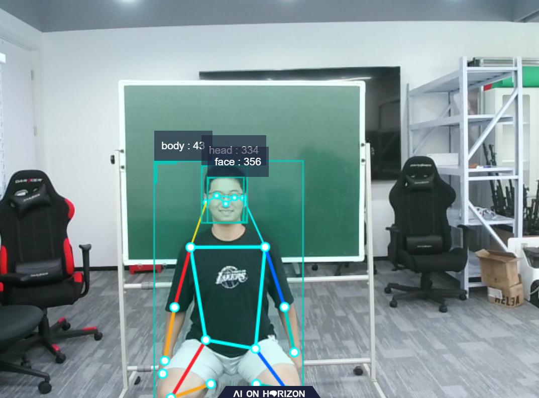

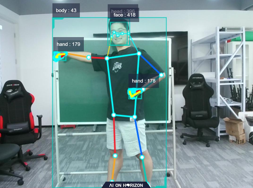

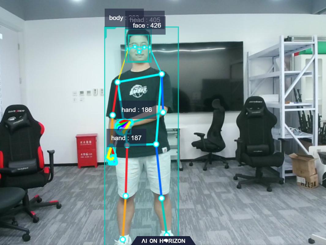

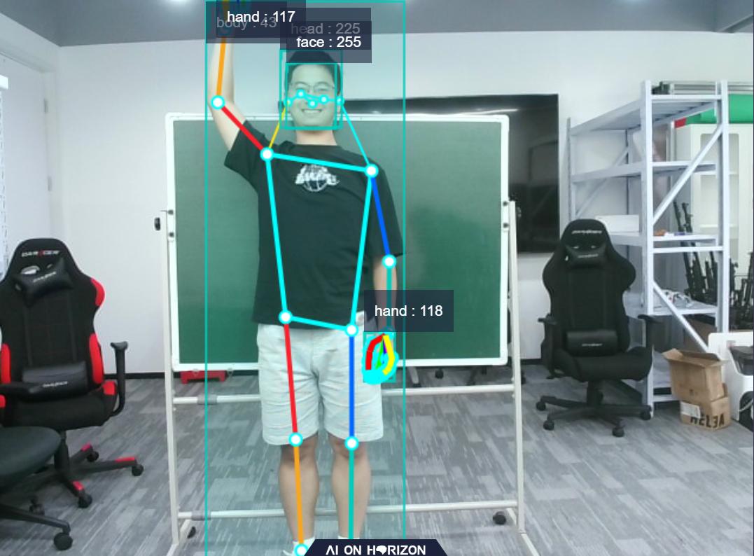

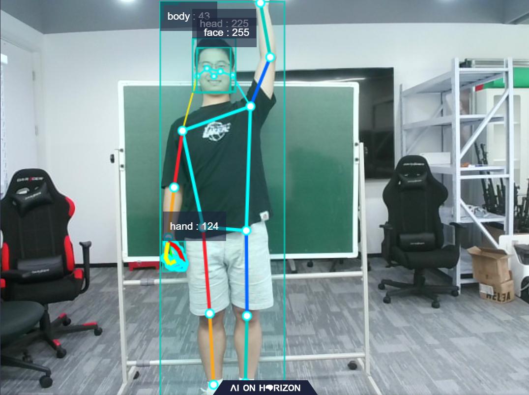

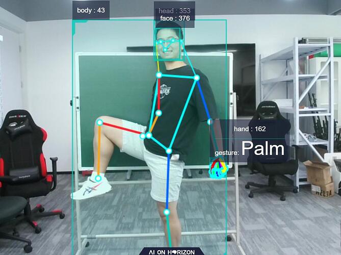

The 1.3X3 PI can run the human detection code
Because the action of the Street Fighter game is too intense, the real-time requirements for human bone detection are also very high, and the current market can be accurate, real-time, and cheap, on the horizon x3 pie, not to say much, directly engaged.
First of all, make sure you have a piece of x3 pie, as well as a camera (preferably usb, the line is a little longer, using a usb camera as a gesture recognition input tutorial see: Gesture recognition algorithm using a usb camera instead of a mipi camera).
Secondly, the Horizon Robot Development Platform software package (HHP) is installed, which is able to run “Gesture Recognition” in section 4.2: The Robot Platform User Manual - the Horizon Robot Platform User Manual 1.0 document
Finally, please download this python file to your x3 pie. Among them, the ACTION2KEY in line 11 must be consistent with the game controls in Chapter 1.1, otherwise the sent keys will not be recognized.

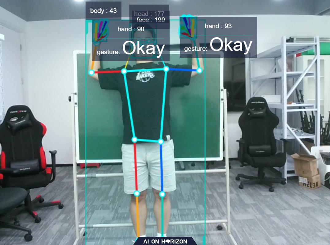

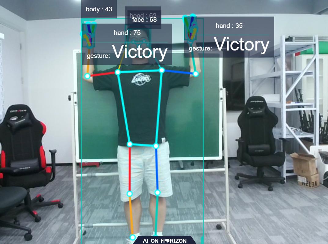

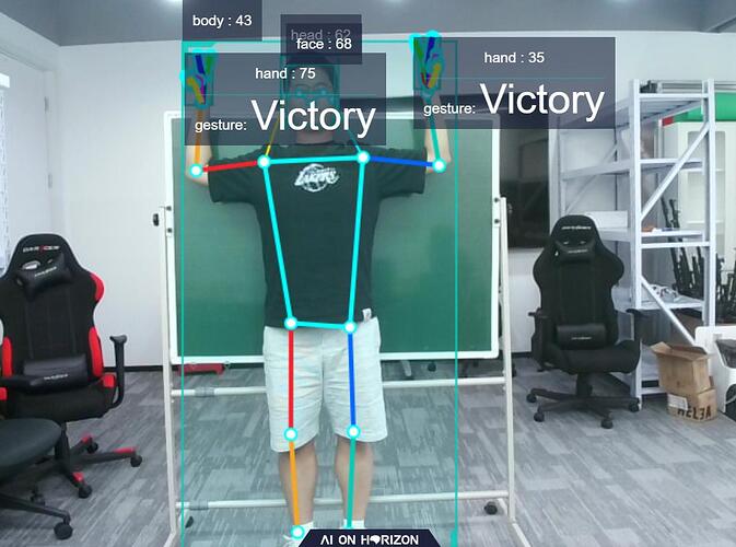

hand gesture:
0: Background,
1: FingerHeart,
2: ThumbUp,
3: Victory,
4: Mute,
10: Palm,
11: Okay,
12: ThumbRight,
13: ThumbLeft,
14: Awesome,
GESTURE_VICTORY = 3
GESTURE_OKAY = 11
GESTURE_AWESOME = 14

        left_gesture_list = [state.left_gesture for state in self.state_list]
        right_gesture_list = [state.right_gesture for state in self.state_list]
        if left_gesture_list.count(GESTURE_VICTORY) > (len(left_gesture_list) / 3 + 1) or right_gesture_list.count(
                GESTURE_VICTORY) > (len(right_gesture_list) / 3 + 1):
            action_list.append('COIN_' + self.name)
            action_num['COIN_' + self.name] = max(left_gesture_list.count(GESTURE_VICTORY), right_gesture_list.count(
                GESTURE_VICTORY))
        elif left_gesture_list.count(GESTURE_OKAY) > (len(left_gesture_list) / 3 + 1) or right_gesture_list.count(
                GESTURE_OKAY) > (len(right_gesture_list) / 3 + 1):
            action_list.append(self.name + '_START')
            action_num[self.name + '_START'] = max(left_gesture_list.count(GESTURE_OKAY), right_gesture_list.count(
                GESTURE_OKAY))
        move_direction_list = [state.move_direction for state in self.state_list]
        if move_direction_list.count(1) > len(move_direction_list) / 2:
            action_list.append(self.name + '_DOWN')
            action_num[self.name + '_DOWN'] = move_direction_list.count(1)
        elif move_direction_list.count(2) > len(move_direction_list) / 2:
            action_list.append(self.name + '_UP')
            action_num[self.name + '_UP'] = move_direction_list.count(2)
        elif move_direction_list.count(3) > len(move_direction_list) / 2:
            action_list.append(self.name + '_RIGHT')
            action_num[self.name + '_RIGHT'] = move_direction_list.count(3)
        elif move_direction_list.count(4) > len(move_direction_list) / 2:
            action_list.append(self.name + '_LEFT')
            action_num[self.name + '_LEFT'] = move_direction_list.count(4)
        kick_list = [state.kick for state in self.state_list]
        if kick_list.count(True) > (len(kick_list) / 10 + 1):
            action_list.append(self.name + '_SKICK')
            action_num[self.name + '_SKICK'] = kick_list.count(True)
        return action_list, action_num

        def kick():
            return (abs(points[16].y - points[13].y) < abs(points[15].y - points[14].y) and
                    points[14].y < points[12].y) or abs(points[15].y - points[14].y) < abs(
                points[15].y - points[13].y) and points[13].y < points[11].y
        right_arm_line_, left_arm_line_ = arm_status()
        move_direction_ = move_direction()
        kick_ = kick()
        return right_arm_line_, left_arm_line_, move_direction_, kick_
