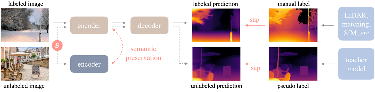

Depth Anything is a highly practical monocular depth estimation solution. Without pursuing novel technical modules, this project aims to build a simple yet powerful foundation model capable of handling arbitrary images in any situation. Its framework is as follows, using a standard process to unleash the potential of large-scale unlabeled images.

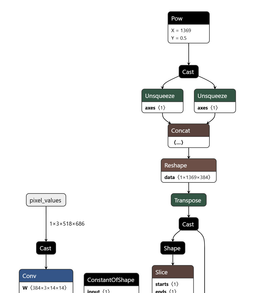

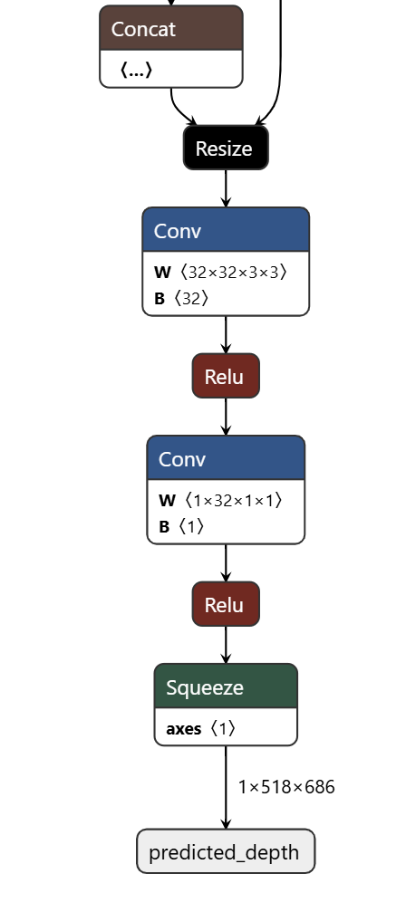

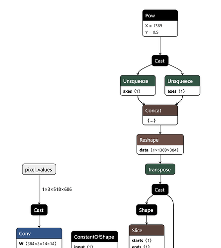

Observing this ONNX model, it only accepts one input and one output. The input is an image with dimensions 1x3x518x686, and the output is the predicted depth map with dimensions 1x518x686.
The model includes most operators being conventional operators such as Add, Conv, Mul, MatMul, etc. However, since it includes a part of the attention mechanism of the transformer, it also includes quantization-unfriendly operators such as Softmax.

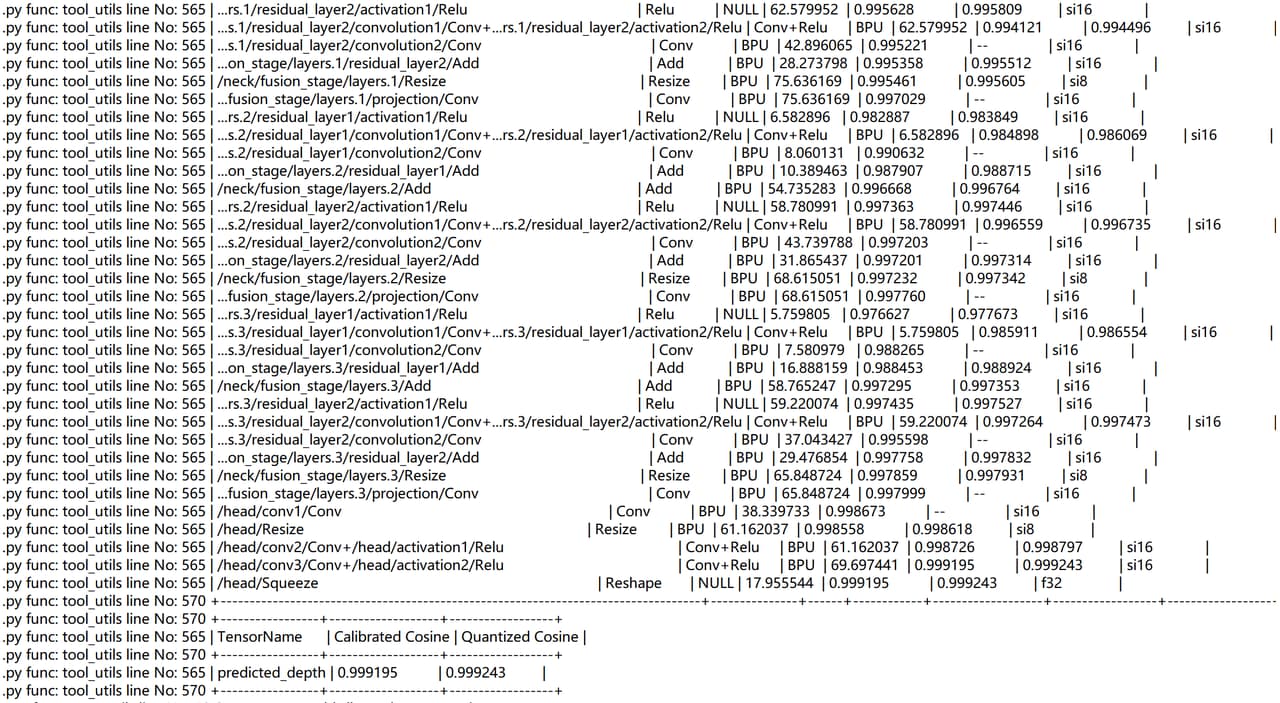

We used the RDK S100 toolchain to perform model conversion on this ONNX model, carried out int16 quantization, and obtained the following results
It can be seen that the quantization accuracy of most operators is greater than 0.99, and the final quantization accuracy is ~0.999

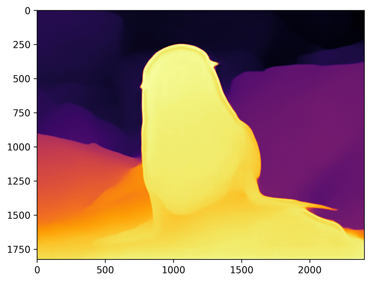

After performing inference using the.hbm model, the following depth map is obtained:
The inference results are consistent with those of the CPU model

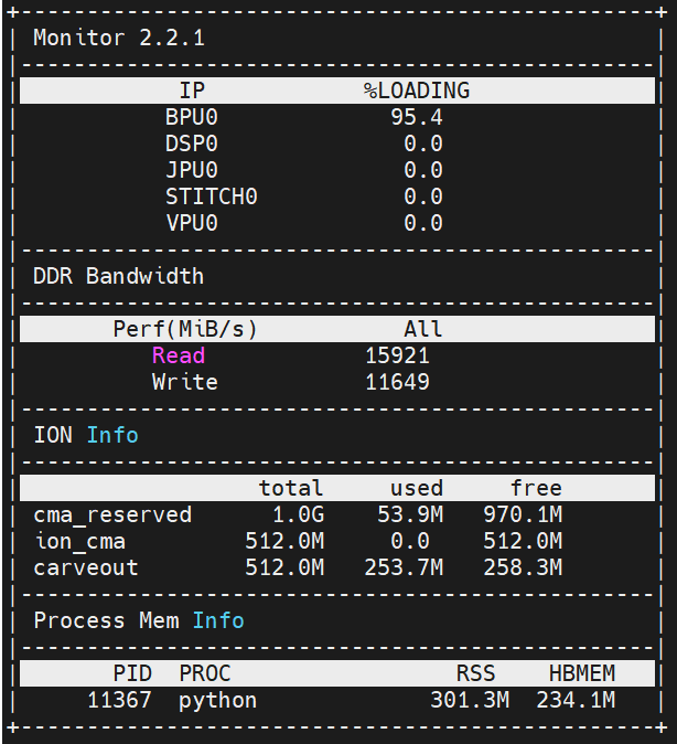

We use the command:
hrt_ucp_monitor
Obtain other indicators
BPU Occupancy: 95.4%
ION Memory Usage: ~300M
Bandwidth Read: ~15920
Bandwidth Write: ~11650
