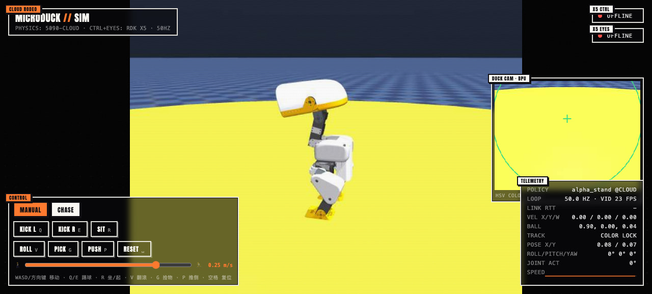

The official browser sandbox lets anyone try a digital Microduck online. We wanted to take the idea one step closer to real hardware by putting motion control and vision on an actual RDK X5.
What we built
The project combines cloud simulation, edge motion control and BPU vision.
Browser ↔ Cloud GPU server ↔ RDK X5
The browser displays the scene and sends commands. MuJoCo provides the robot model and physical simulation. RDK X5 runs the 50 Hz ONNX locomotion policy and uses its BPU for DOSOD ball detection.
The policy takes IMU and joint observations as input, then outputs motor targets. The vision pipeline processes the duck’s camera feed, finds the ball and lets the board decide how to turn and approach it.
